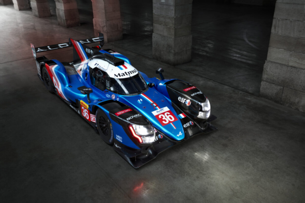

Alpine A480

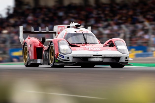

Glickenhaus SCG 007

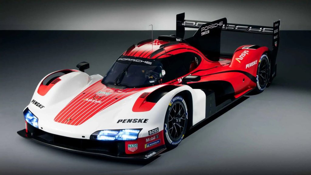

Porsche 963

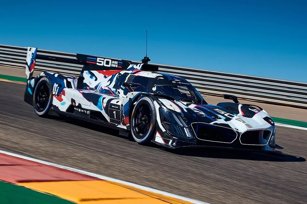

BMW m-hybrid V8

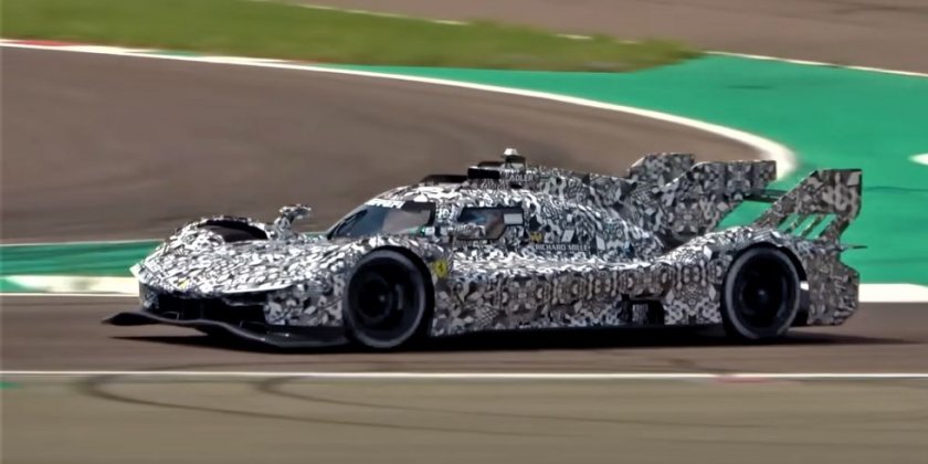

Ferrari LMH

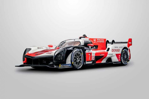

Toyota GR010 Hybrid
Alpine A480

Glickenhaus SCG 007

Porsche 963

BMW m-hybrid V8

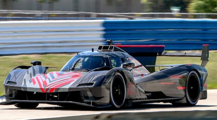

Cadillac V-LMDh

Ferrari LMH
